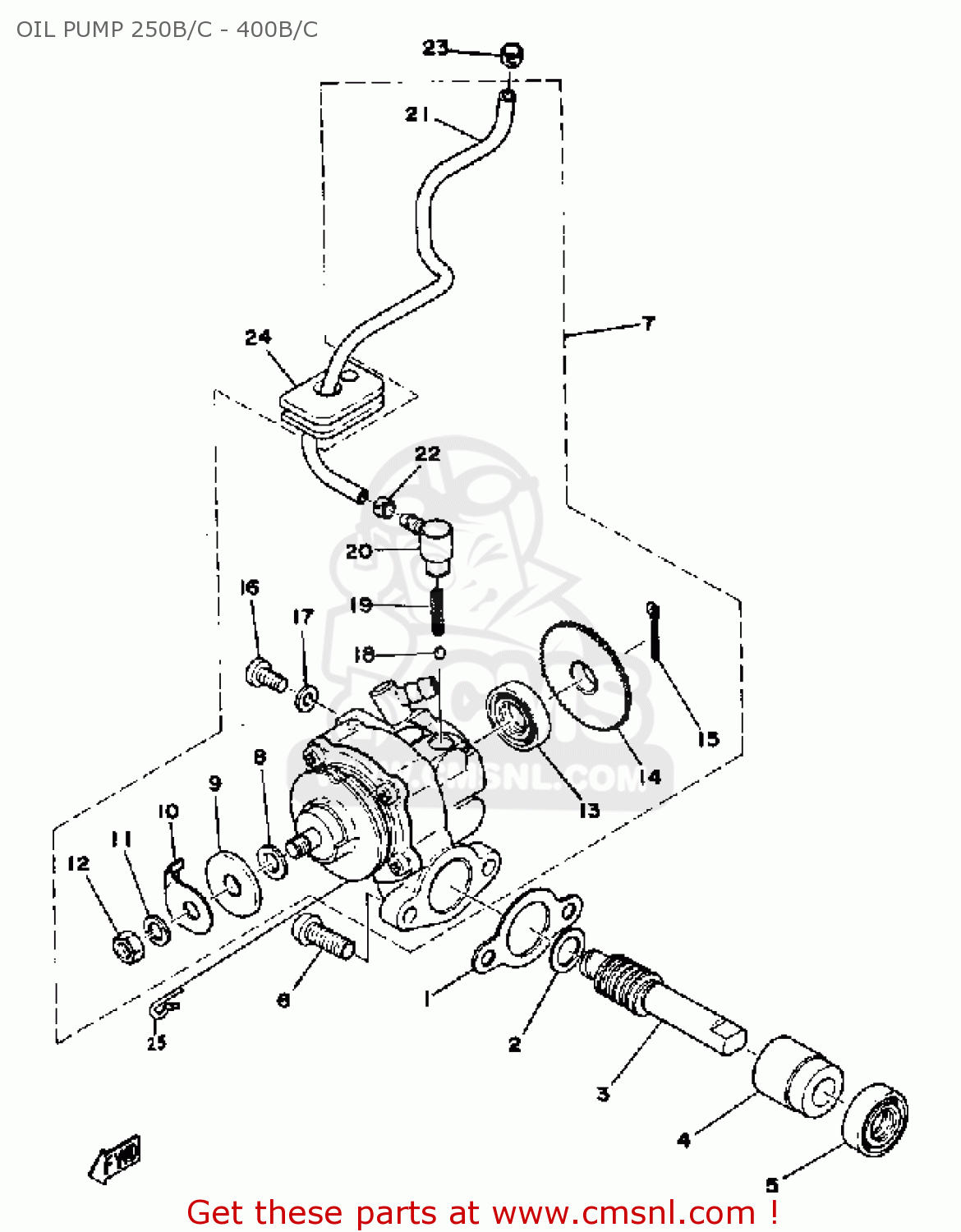

- Posts: 11130
- Likes received: 4932
Replied by RT325 on topic 75' DT250 : Oil Pump Drive Shaft Question?
Ok i was wrong. Here's the schematic showing it just pulls out. I see it shows a washer too on the pump end so you'd need to be careful it doesnt drop off & stay loose in the pump body when removing the shaft. I guess none of that helps as to why it broke though. images.cmsnl.com/img/partslists/yamaha-d...yau1068a-11_46fb.gif
