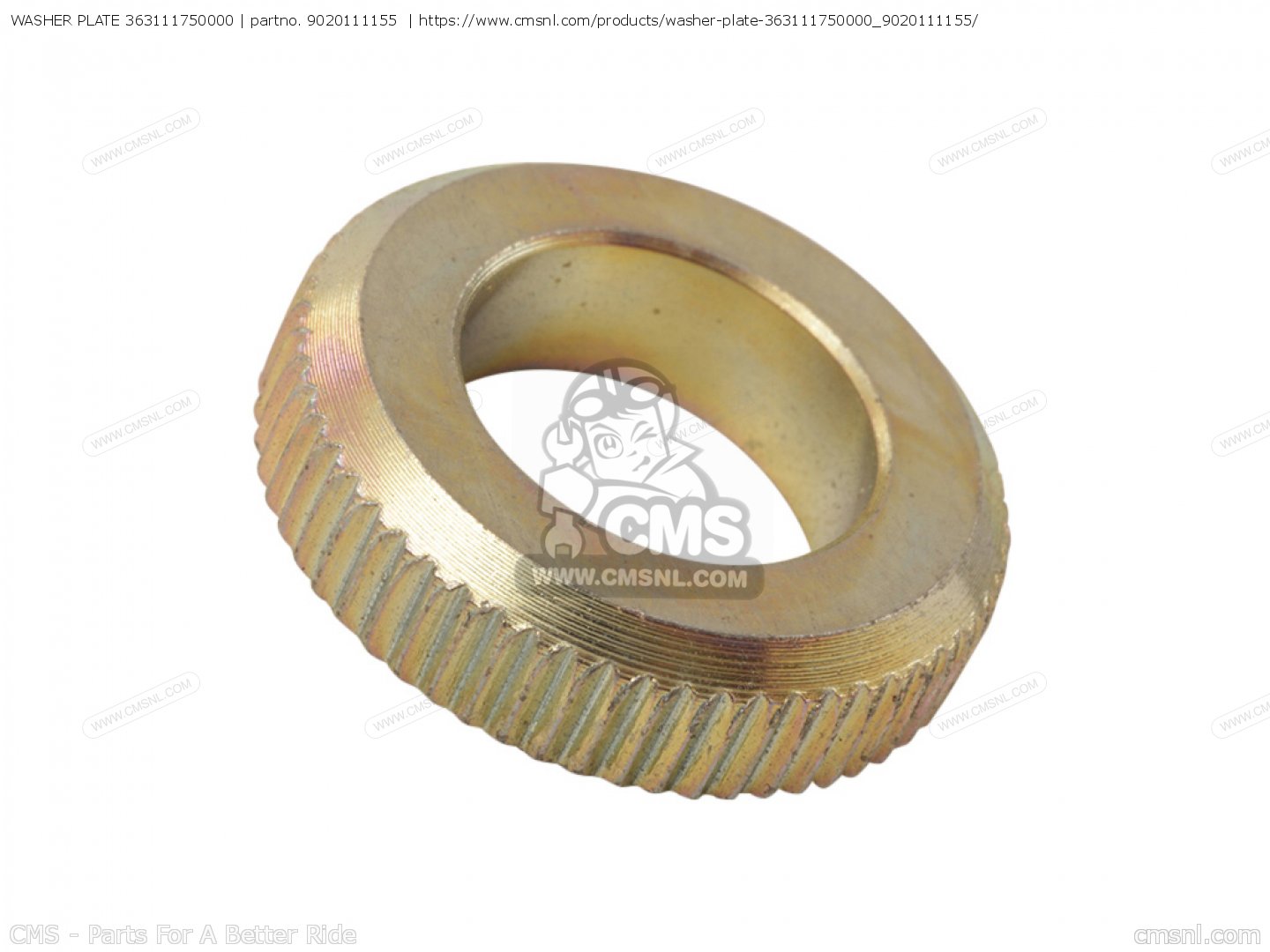

Unfortunately I lost the washers for the cylinder nuts...
More unfortunately it seems you cannot order these...
Does anybody could tell me the measurements for this washer plates?
Cant find it in the parts list etc.
I found some aluminium washers with 2 mm thickness online, but i dont know if this would be enough.

Gosh don't use aluminium washers they will just squash out useless. Ive forgotten what bike but if dt250 or dt400 I don't think they have washers under the cylinder nuts down the holes in the fins which would be 10mm studs & deep 10mm alloy nuts. The head studs will be 8mm with normal thickness 8mm steel washers not useless wafer thin washers like I see in our local $2 shop. Happy to be corrected if I've got the wrong bike or I'm on the wrong post.
- Posts: 11130
- Likes received: 4932
Replied by RT325 on topic Engine compression
OK I'm half wrong lol. Looking at a dt400 1975 on cmsl it shows a thick serated special washer under the deep cylinder nuts. But I think they're pressed into the cylinder hole where the stud comes through & it never comes out. I guess if one did happen to come out then at least they're available.

The cylinder washers often are stuck in the holes. Be careful not to double them up.

images.cmsnl.com/img/products/washer-pla...20111155-01_549f.jpg check out the pic of number 9. Not removable I think & not likely to fall out onnce in there. Just saying.
