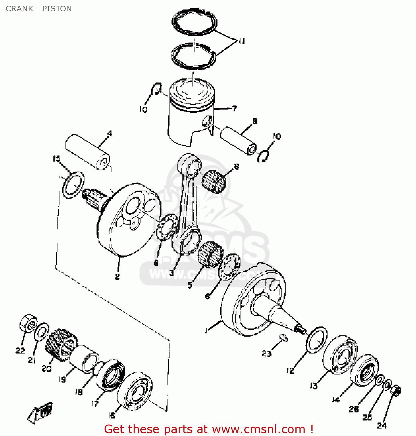

Replied by RT325 on topic 1969 CT1 Pops but won't start
images.cmsnl.com/img/partslists/yamaha-c...gyau0828a-5_d6b1.gif
I can't find the retainer but here it shows it on a CT2 #25 & # 24
images.cmsnl.com/img/partslists/yamaha-c...gyau1118a-5_d975.gif
Even with the retainer they'll still push out if the case is full of fuel as seals just get tired of hanging in there but are still ok sealing on the shaft.
Could fit two retainers if desired as the threaded 8mm holes are opposite each other & used for the case & crank puller--pusher.
Just be careful the head of the 8mm screw or a bolt you might use doesn't touch the clutch basket gear if you add a second retainer.
Anyway, a new seal will stay in as will be tight without needing a retainer but think i'd still oil the seal outside plus the case to help it slide in so as not to grab or get damaged.
