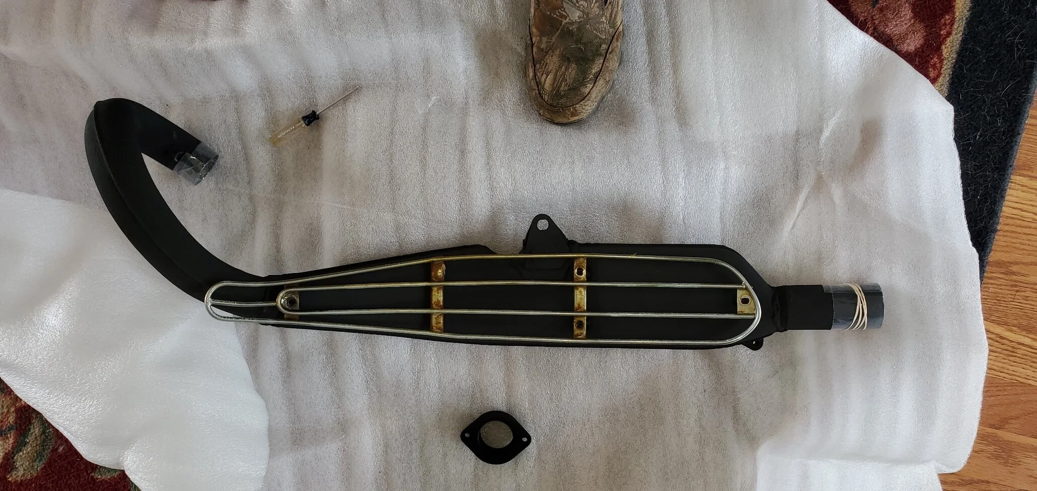

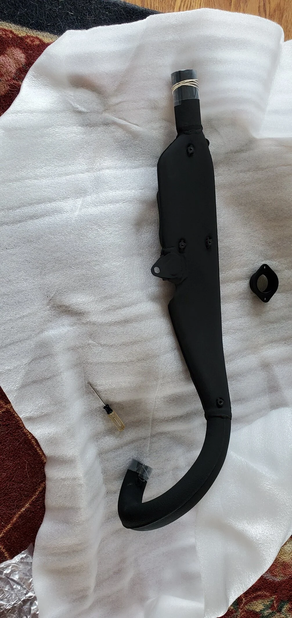

Arrived from Jet-Hot today for the 250:
I think it turned out perfect. It looks like a hole in the light.
Hi-Rez image links:
www.stangnet.com/mustang-forums/media/ex...oat02-jpg.14932/full
www.stangnet.com/mustang-forums/media/ex...oat01-jpg.14931/full
Hi-Rez image links:
This message has attachments images.
