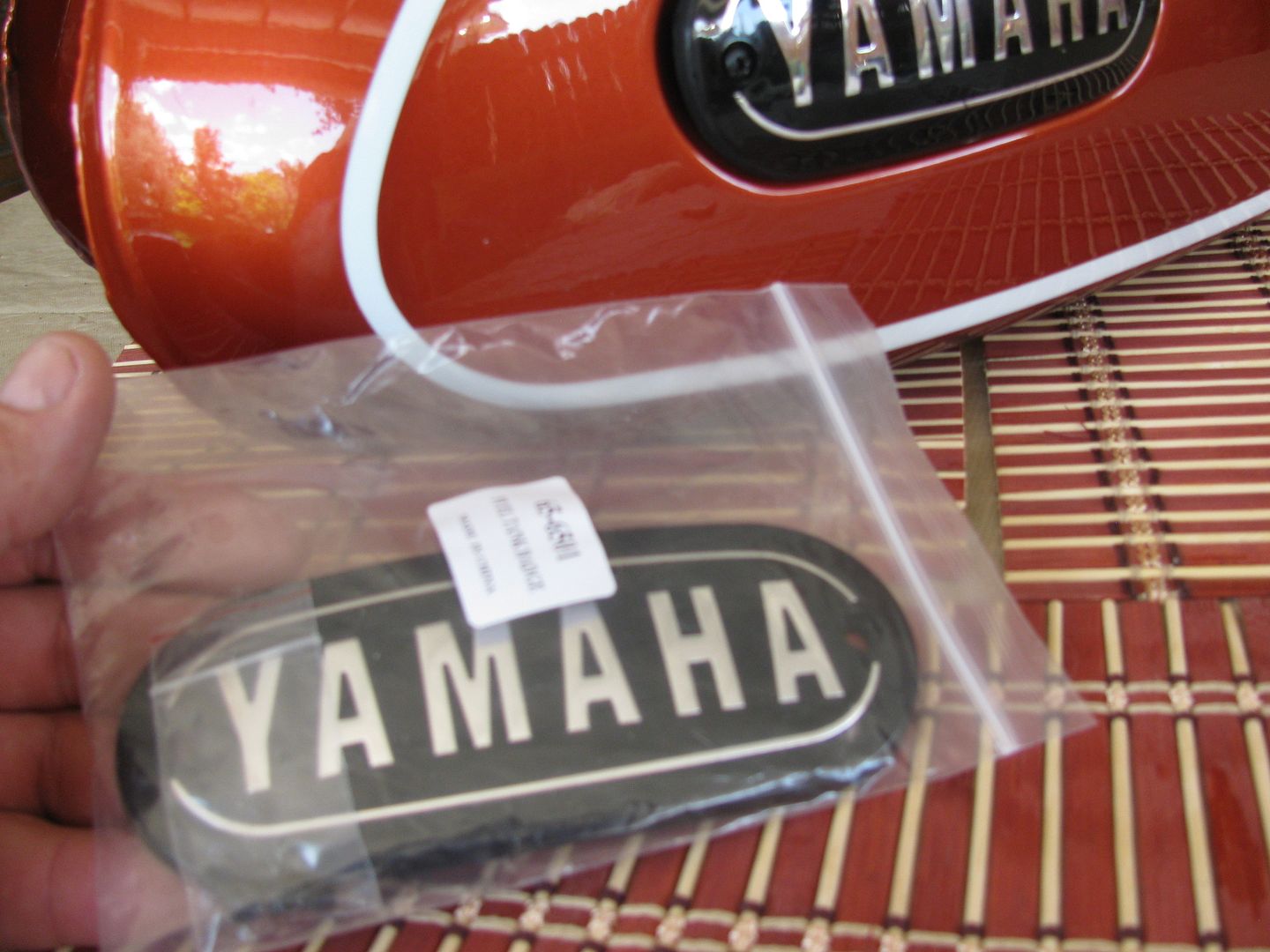

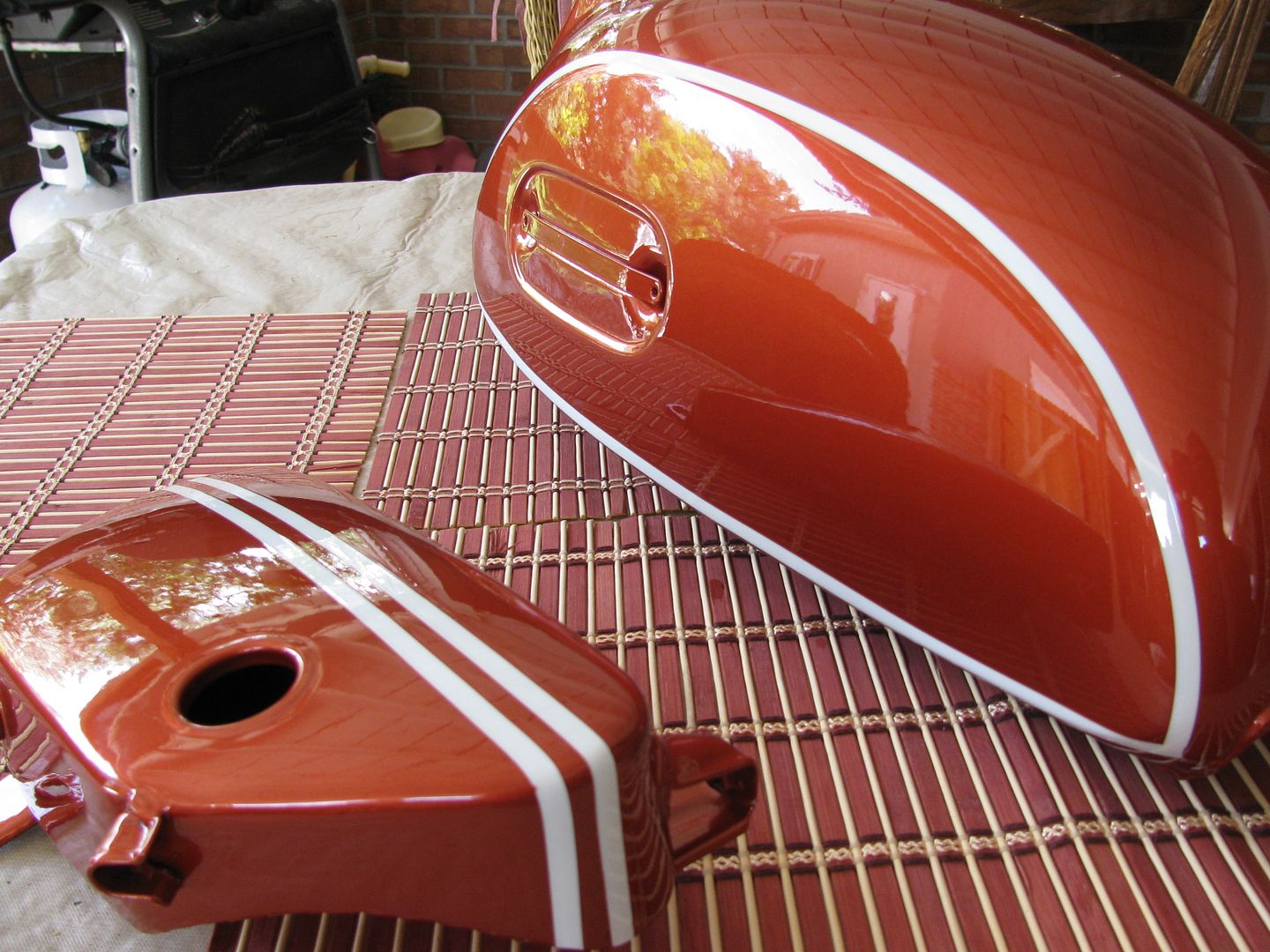

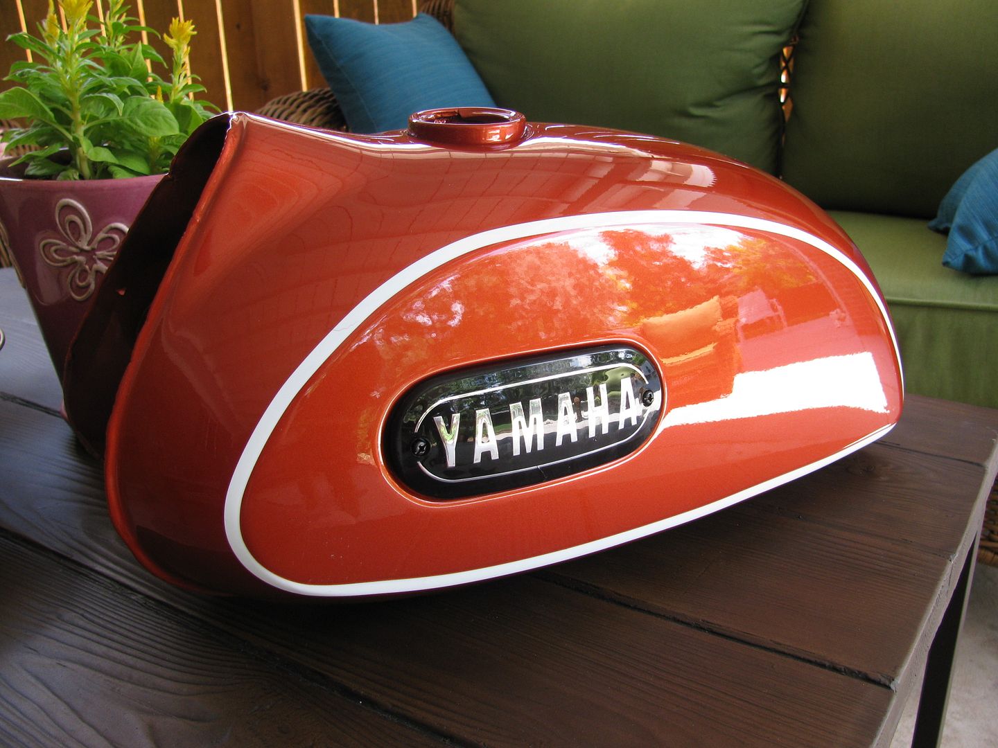

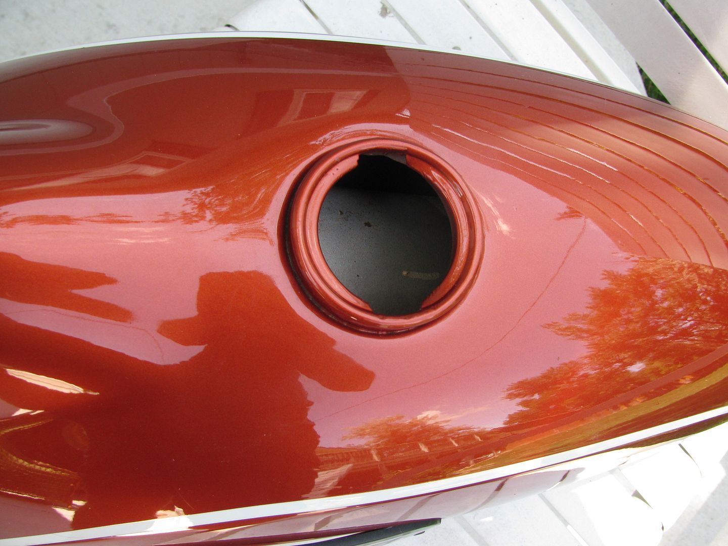

Now its getting Serious!
Christmas came early for me- Paint turned out amazing!
I have the new "250" decal to go on the Oil Tank... will just lightly scuff pad the paint and apply decal and reclear it.
Wont be long now!
Wont be long now!

Replied by eddy20 on topic GFrench- 1971 DT1F MX Restoration
Where did you get the new tank badges? I need to order some for my 69 DT1 and 70 DT1-CM.
