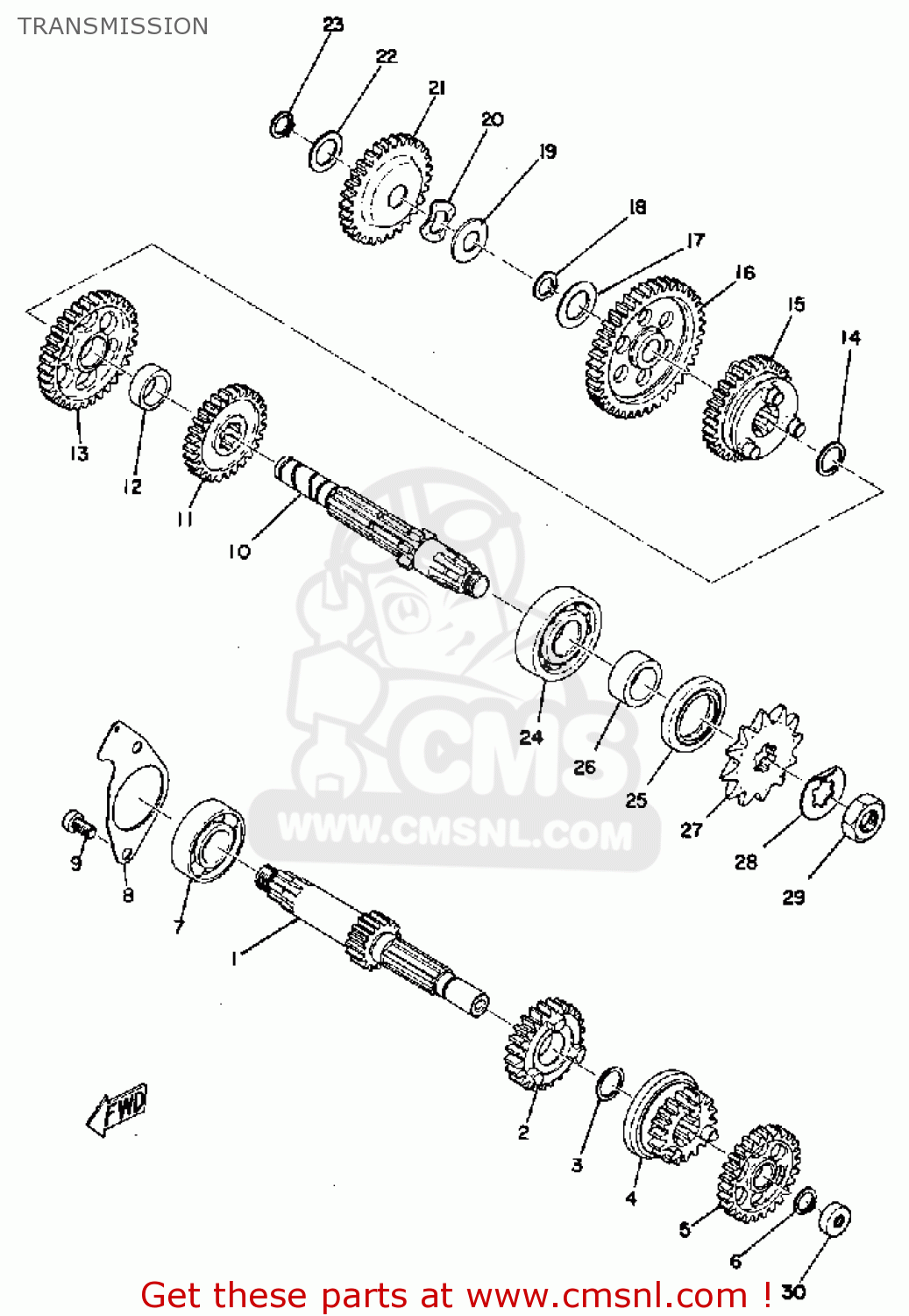

Thanks RT for your insight. I can take that axle main and push it then pull it through the bearing. I can see it sliding through the middle of the bearing. I did remove the seal on opposite side to see if I could see anything there. Does that make any sense RT. Thanks for the help I really appreciate it. Bob

I guess ya push pulling the mainshaft without the cluch hub on so yes you will get movement but once its all bolted over against the bearing in the case you shouldn't get movement. No5 is retained by a circlip & revolves in a 4 speed like this but can't move sideways so all good.
Only mentioned No5 as in a 5 speed trans the end gear is small & pressed on very tight. But none of that is helpful sorry.
images.cmsnl.com/img/partslists/yamaha-j...yau0825a-10_0d47.gif
providing the bearing retainer plate No8 isn't bowed out--then nothing should move sideways, not to be confused with a little clutch basket free play needed to revolve when in gear with the clutch pulled in--as in seperated--as happens during gear changing also. Sorry i'm woffling on.
