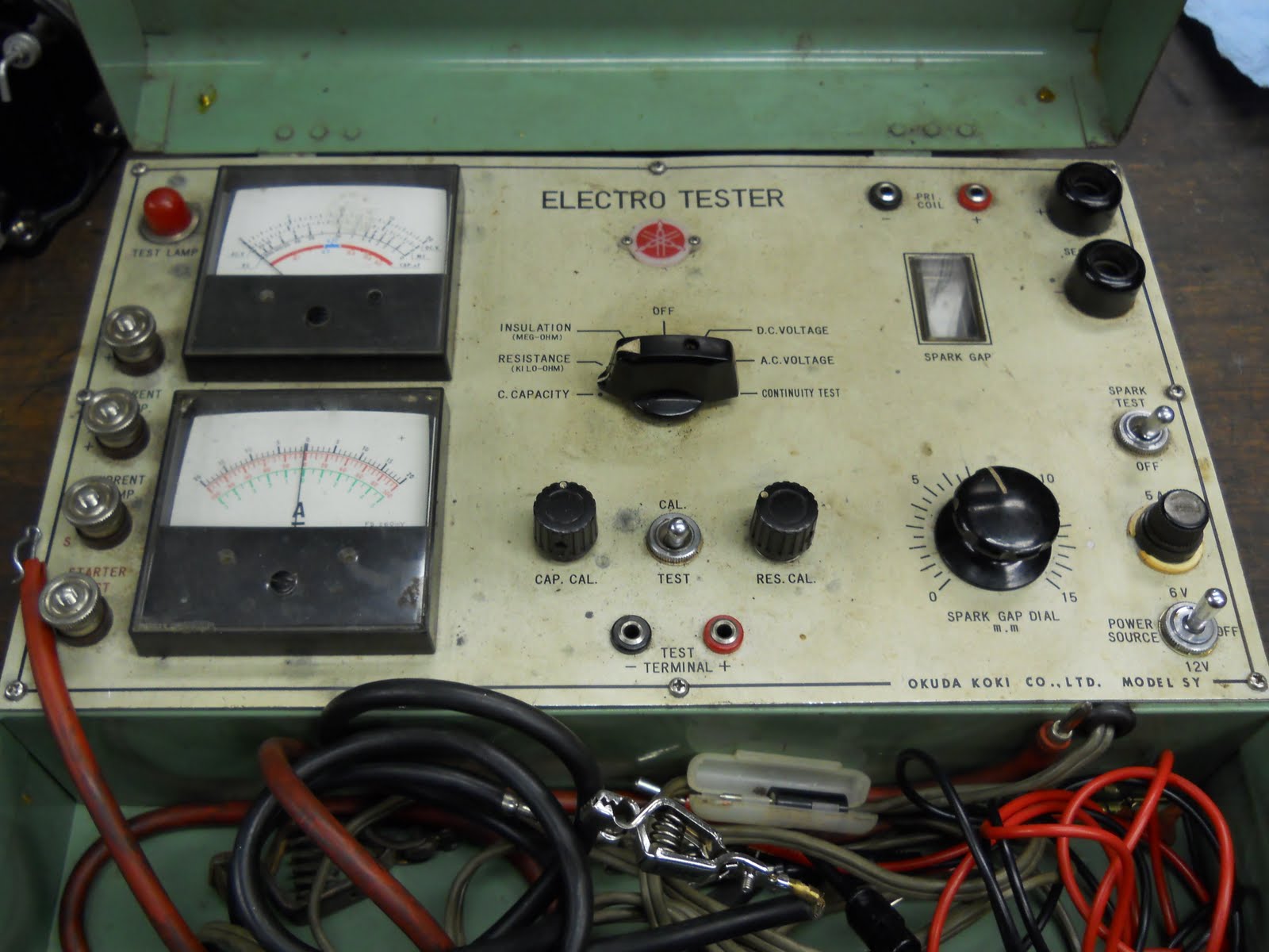

Now that would be a great piece of equipment. Like a battery load tester. Battery measuring 12.5 volts but fails immediately under load.
I found a picture of a Yamaha Electro-tester. It says it used a spark gap of .25" as a measure of a good ignition system...now that is a GAP.

I've got one of those Yamaha testers like Mark describes.
Had it at work since the "70's or maybe late "60's.
Initially with the single wire magneto AC ignition coils we thought almost every coil was faulty but Yamaha put us right by telling us that if they draw less than half an amp then to test them on 12 volt.
Back then most magneto ignition systems were 6 volt on the DC charging side to the battery so we tested the single wire AC coil on 6 volts.
Often tested ok but the odd one drew less than half an amp so 12 volts livened them up.
Too long ago to remember but maybe the "less than half an amp" coils were shorting out inside giving less resistance hence less draw?? or would it draw more?? & faulty--not sure now.
I guess a bit lol. Never had many truly faulty coils over the years.
It was good with the adjustable gap in a glass window & was interesting how far the gap could be widened until it misfired.
It was the tester that tested "everything", not that it ever got put through all its modes.
